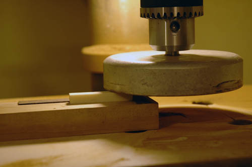

This first pictures shows the sander in my drill press, and a simple holding jig I made. The jig is just a piece of maple, with rosewood glued to it to hold small parts. I just used superglue to glue this up. That way you can have a jig built for a specific purpose very, very fast.

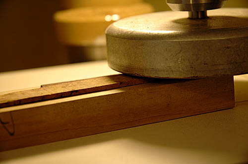

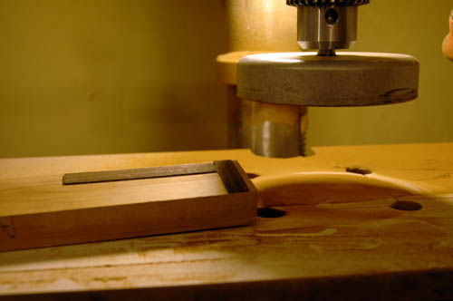

I use this jig to thickness and shape nuts and saddles. I will only show doing a nut, the saddle goes the same way.
Here I am thicknessing my nut. i start at 120, and switch to 320 grit when I get close to final thickness.

p.s. Note that all pictures are taken with the disk turned off. That's for my safety as a photographer.
Also note the direction the disk spins. I have that nut positioned so that if it catches, it'll fly away from me rather than into my face. I've launched a few pieces, and while it is nothing like a table saw kickback, you wouldn't want to take it in the face.

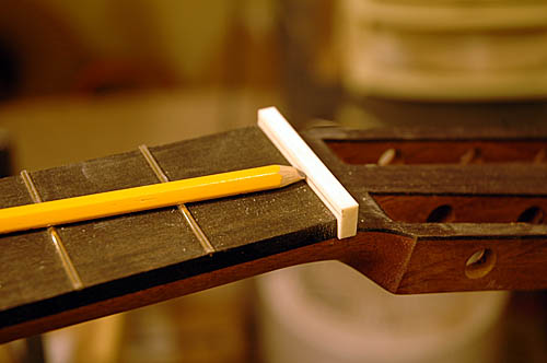

Okay, so here I use a half pencil to mark about where I want the strings to lie.

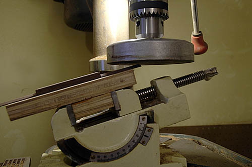

Now I use my handy angle vise to take down the top of the nut, and impart the back angle at the same time. Of course you will need to do some hand work to finesse the shape, but this gets you in the ballpark very fast. I go to within about 1mm of the line, as of course you need bone above the bottom of the strings.
edited to add: note that the nut is on the UNSAFE side of the sander in this photo. I wanted to show the angle adjustement for the vise. If the nut escaped from the vise, it would be launched into my face or body in this photo. In reality I always sand on the left side of the disk.rlabbe38533.502974537

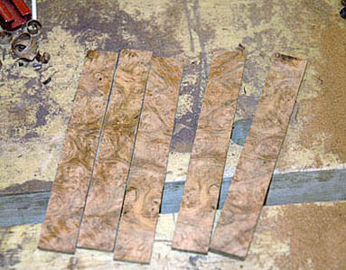

This next sequence shows how to make veneer with the disk. Here I am slicing a pen blank into pieces for a rosette. I'm using a very powerful and accurate resaw called RogersArm. Its rated at 1 bp (bicep power).
PostPosted: Thu Jun 30, 2005 12:16 am
Posts: 372
Location: Golden, Colorado
First name: Roger
Last Name: Labbe
It's pretty much smooth enough to inlay, but I was chicken and sawed them thick to allow for mistakes. So off to the drill press we go...

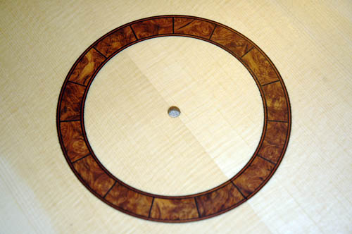

Guitar elves sneak into the shop during the night, and the next morning a rosette is inlaid and ready to go!

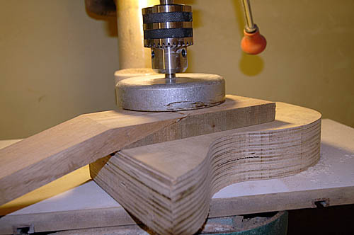

Finally, here I am using the disk to flatten the top of a scarf joint after gluing it up. Sure, a plane works too, but this is pretty foolproof. I'll reach for the plane if the disk is not chucked into the drill press, but if it is chucked I go this way. Just whatever is faster at the moment.
I use the plywood to get the neck off the table so it'll lie flat. It's not apparent from the photo, but I used some double sided tape to hold it on, because the piece underneath is not that big. If anything tips, you could cause a jam and launch the neck across the room. In general, anything you sand with this jig had better be wider than it is tall, or otherwise you are courting disaster and injury. A nice stable platform is required to keep things safe.

[QUOTE=rlabbe] Guitar elves sneak into the shop during the night, and the next morning a rosette is inlaid and ready to go!
That is a beautiful Rosette! Can I borrow those elves?

Excellent tutorial! Thank you. Gives me lots of ideas for the sanding disk I have.
Did you add a black purfling line between the rosette pieces or is it something else? Awesome rosette!

[QUOTE=Jeff Doty]Did you add a black purfling line between the rosette pieces or is it something else? Awesome rosette![/QUOTE] Yup. I cut the veneered strips into trapazoids, and glue them one by one onto a sheet of carboard, with purfling strips in between. Use a router to turn it into a circle, cut it off the cardboard, inlay into soundboard, rout an inner and out channel for the purfling, and inlay the purfling.

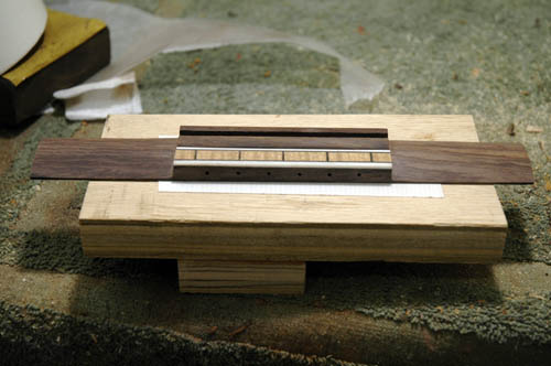

I left out a couple of picture I intend to add tonight. I build classical, and I use the disk sander with a jig and the angle vise to create the bevelled edges on the wings of the bridge.
Some people recommend cutting out the center of the sanding disk so there is only a 1" circle of paper around the perimeter. I haven't found that particularly useful, but can see how it may help with things binding up.
PostPosted: Thu Jun 30, 2005 10:43 am
Posts: 372
First name: Roger
Last Name: Labbe
Okay, here is a classical bridge taped down to my high tech bridge sanding jig. It's just two pieces of wood superglued together.
PostPosted: Thu Jun 30, 2005 10:45 am
Posts: 372
First name: Roger
Last Name: Labbe

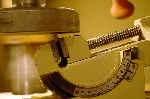

Here I have put it in my angle vise. A few seconds of sanding and I have a perfect bevel.
Flip the jig 180 degrees, and do the other side.
